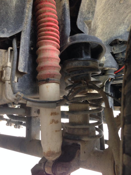

heres the suspension
Old 05-28-2014 | 04:27 PM
TheDirtman's Avatar
Joined: Oct 2010
Posts: 6,222
Likes: 367
From: Southwest Reno, NV
skyjacker budget boost. Measure that spacer above the coil isolator to see how much lift it is.
Set up improperly with about 1" of up travel.
