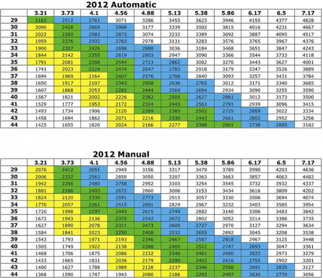

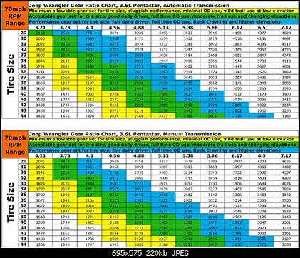

If you check the stickies at the top of the modified JK section (or the tab on the phone app) there's a thread for FAQs, questions every newbie has. Gears versus tires are discussed there, including a couple very handy charts.
