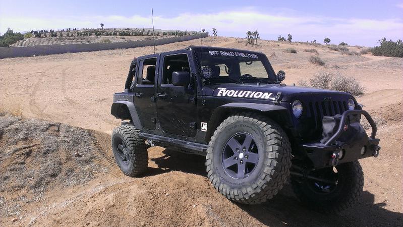

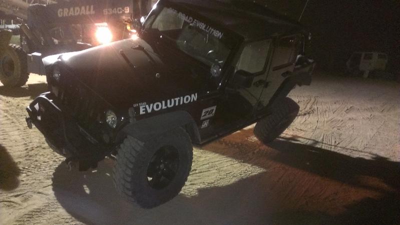

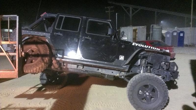

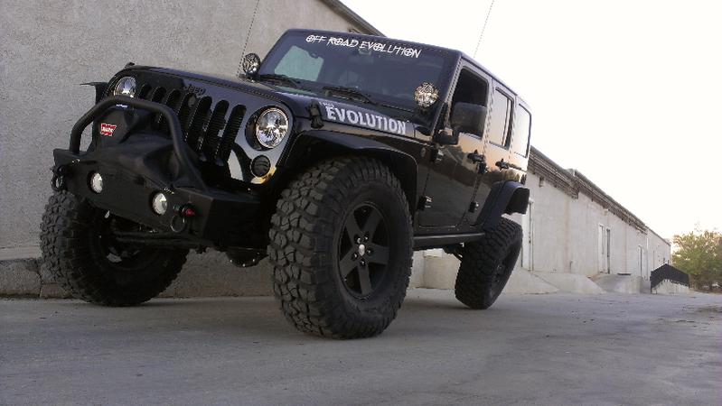

I had this same setup last year. Tf 2.5", 1.25" RC body lift. 37" km2's, stock bumpstop up front, tf 2.5" bumpstop in the rear, stock rubi shocks with tf extensions, trimmed fenders pinch seam and rubi sliders. I will post a few pics of it then and my jeep now
Old 05-15-2013 | 06:17 AM
bob-o's Avatar
Posts: 2,215
From: rosamond, ca
Tf 2.5",rubi shocks and extensions, 1.25 body lift

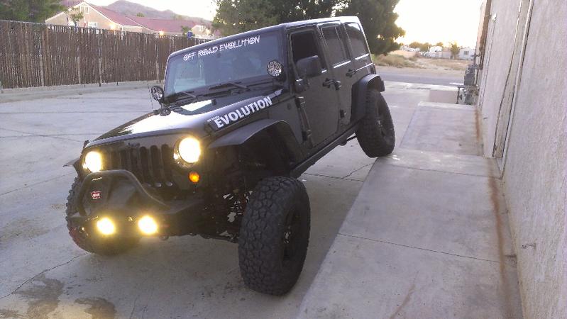

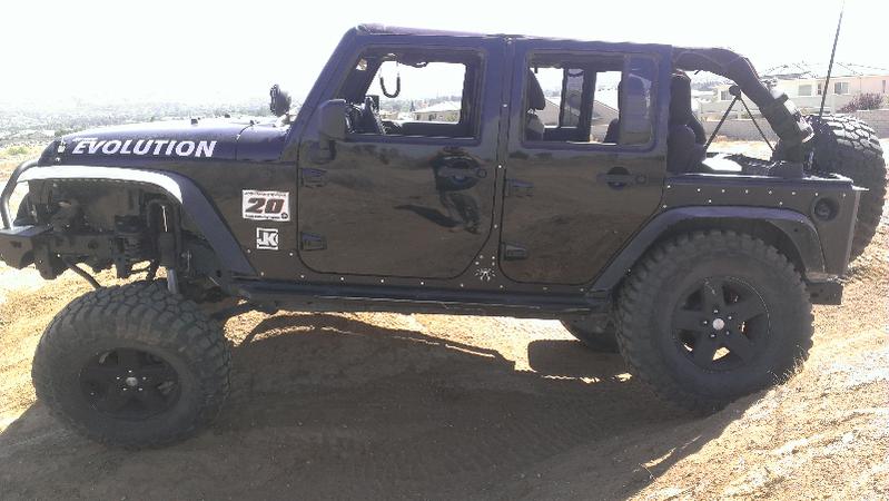

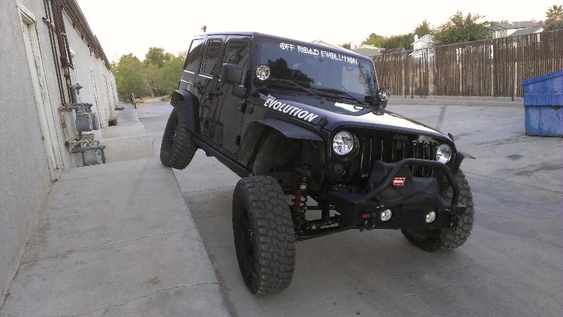

Now I have 2.5" rk coils up front, rear lower and upper spring retainers, front lower spring retainers, evo rockstars, bilsteins for a 4" lift up front, 2" rear, 1.75" bumpstop on front lower perch plus the factory bump, tf 2.5" rear bump stop, 9" long rear sway bar links, 11" long in front

Do you still have a body lift? And is it needed to dit the 37's. I'm not a big fan of body lifts so if I need another inch of lift to run the 37's I wil probably get new springs.
Old 05-15-2013 | 08:09 AM
bob-o's Avatar
Posts: 2,215
From: rosamond, ca
I do still have the body lift. U can fit 37's without a lift and have flat fenders but without the body lift u would have to run taller bumpstops front and rear,
or run. 1.5-2" extra bump stop in the front and 2.5" in the rear plus some extra trimming off the rear pinch seam
