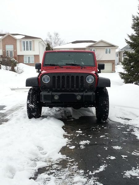

Just did this about a week ago now, used a metal grinding disk and just measured 2 inches from the front and taped it off ontop and the bottom, very easy took me about 10 mins just to cut through it but after i drilled a 9/16 hole on the metal bracket that holds the front bumper onto the jeep (because you cut off the stock bumper mounts) then used 3/8s bolts, washer, nuts and painted her black! I think it gives it a nice look aside from the wings practically hanging over my tires. Tell me what ya guys think of this!?

thanks guys, my buddy one day said he'd seen a jk and it had a stubby stock bumper, looked up online and sure enough theres posts and pictures about it, so had everything i needed then bam done. Now time for my lift/tires/gears
