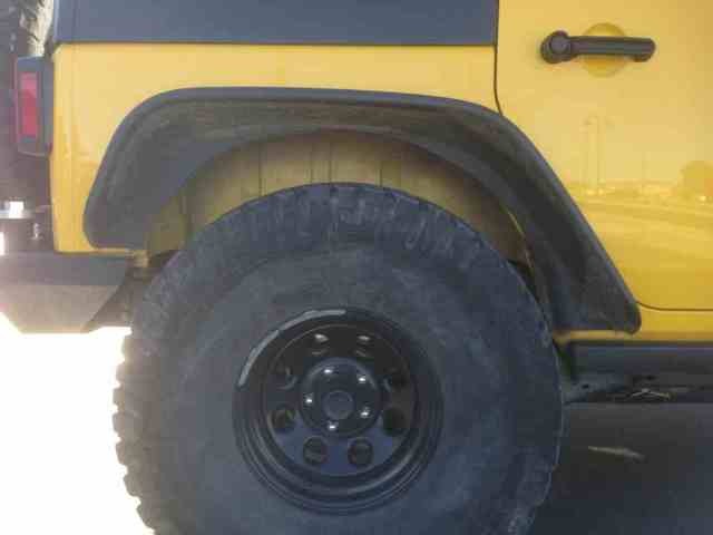

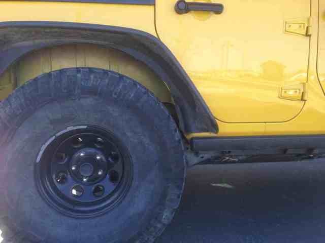

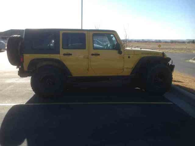

Here you go, this was no lift and 37" Toyos with Metalcloak fenders. If anyone is thinking of this setup you will want at least 4" BS on your wheels and I would also recommend smaller 37's like the BFG's to help keep the tires from hitting the frame at full steering lock. These tires also just hit the fenders at full stuff and you'll need to trim alot of your pinch seam in the rear.
Forum Tech Advisor
This has a coil spacer in the front to level it out. The front has 1" extended bumpstops and the rear has 1.5" extended bumpstops. It could use just a little more.
2"+ has been cut off the back of the Rubi sliders.
The wheels have 4" backspacing.
The rear fender well has been significantly trimmed, and needs more.
