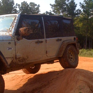

I have JKS ARCOS spacers up front maxed out to 2.75 and 1.75" spacers in the rear with my 35's on stock wheels. I also have spidertrax 1.5" wheel spacers. The tires don't rub on the trails even at max flex because the tires tuck under the flares (see pic). On the road they used to rub if I had big dudes in back and hit a bump but I've lowered the bumpstops to fix that.

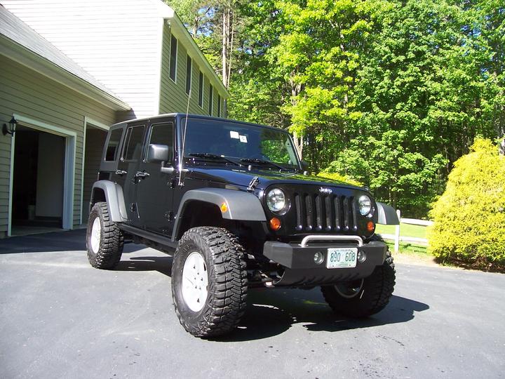

35's on stock 17" rim. Has a 3"BDS and a 1.25" BL just because.
ID:	84313   Click image for larger version
ID:	84314   Click image for larger version
