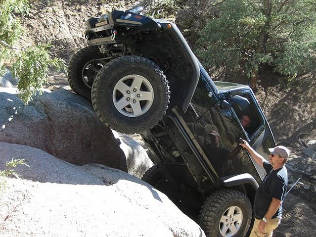

Earlier this year, I experienced enough articulation to pull the front diff vent off. So I extended the vent w/a longer piece of tubing. I left a good deal of slack (think of a big, droopy "J" coming off the diff) and added a hose clamp too. Figured I was good to go.
Enter Chinaman Gulch last week. If you don't take bypasses, it's gnarly. We spent nearly the whole day climbing up and down the trail's considerable boulders and waterfalls.
Turns out, spending so much time with my nose in the air (trying multiple lines, mugging for the camera, etc.) allowed gear oil to fill the "J" in my vent and spill out. Ounce by ounce it went.
The next day (with diminished oil level) I got on the slab and ran 75-80 mph back to Omaha. The end of my vent sits out in the open behind the radiator, a high airflow area. Fast moving air running across the top of the breather may have created negative air pressure, further draining my front diff during the ten hour journey back to Nebraska.
Once home and slowed down, I immediately detected the nauseating sound of pinion bearing failure and found my vent line shiny and dripping with gear oil. My gear man confirmed my fears. I've got a master overhaul kit coming from Northridge.
