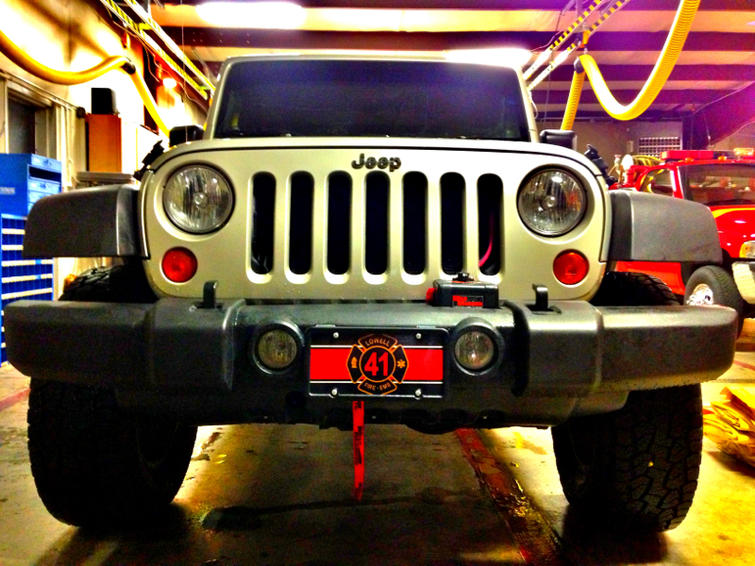

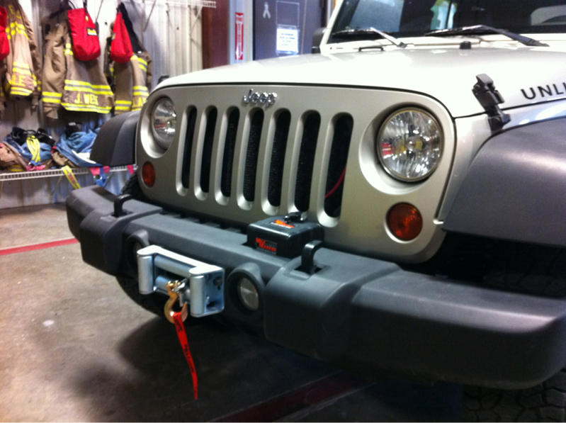

yes. mounted inside the factory bumper. here's a better pic. it's upside down between the frame rails and fog lights. then extended solenoid wires and cut bumper out around it.
