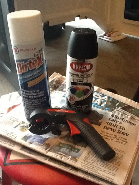

This prep stray was the best I've every used, I use it to clean all kinds of stuff now, I used a auto primer and the satin black to paint the inside it took 5 cans and 2 cans of clear

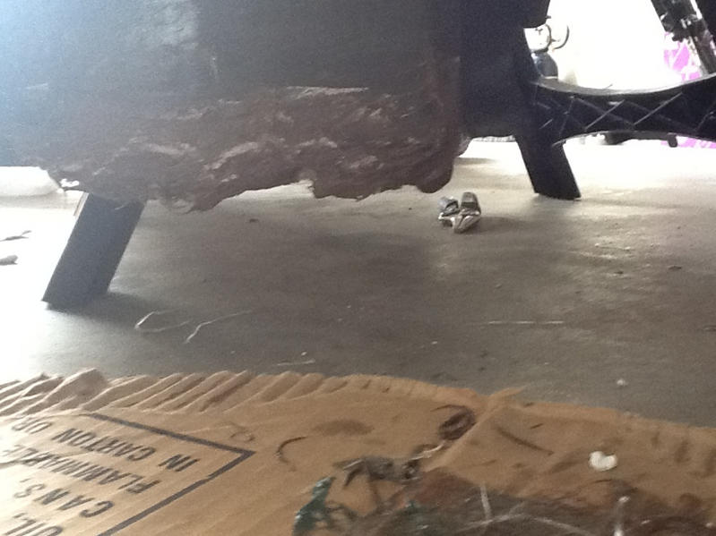

Added the Bondo Glass nice and thick, the heat from the compound kept it from sticking to the styrofoam on the back

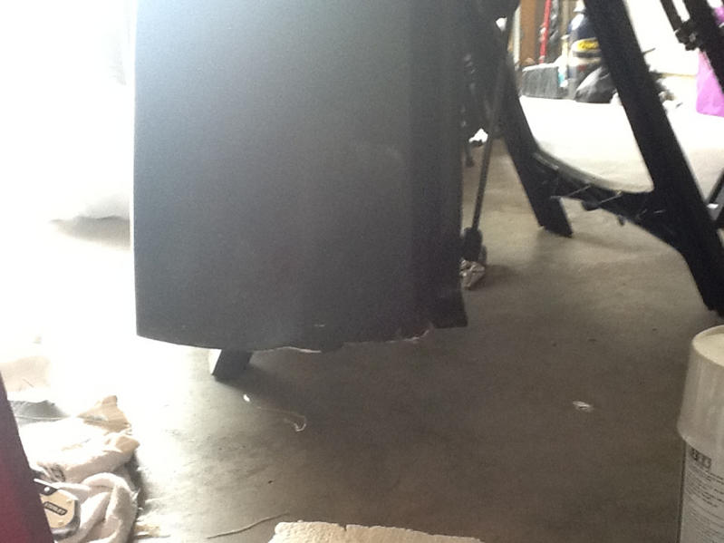

Once it was ready I took my time and sanded it with 80 grit sand paper. I was using my sander so it was easy

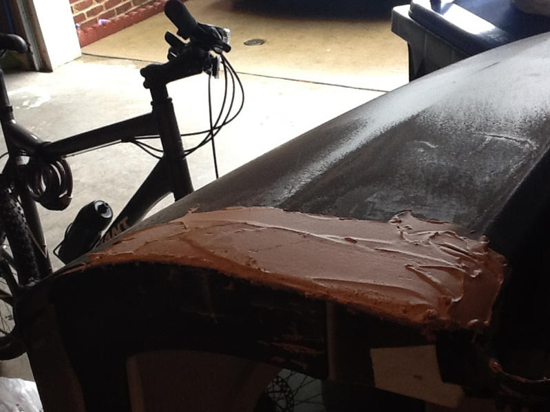

Laid of the Body Filler to get a true hard finish, with the Filler I spread it on the inside lip also to help with the strength
Sanded down the Body Filler

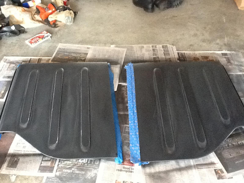

I painted the inside first, I took my time and did light coats until I got the look I wanted. It was around 4 or 5 coats then two coats clear
