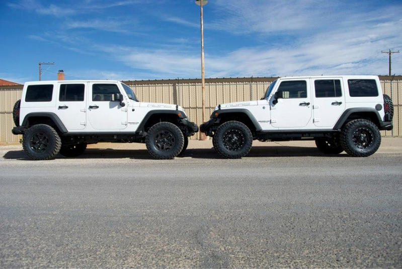

MOAB on the left is running a BDS 4.5" long arm system with LT35x12.50R17 NITTO TRAIL GRAPPLER M/T on the stock MOAB WHEELS with 1.5" hub centric spacers!!
The MOAB on the right is running a 4" MOPAR suspension system w/ LT35x12.50R17 NITTO TRAIL GRAPPLER M/T on 17x9 FUEL REVOLVERS!!

4 inch lift for 35s is a little over kill. Putting heavy tires on stock tire carrier. I see the dual steering stabilizer on one of them.
Did you guys weld some c gussets up or put front drive shafts in. Also what wheel spacers did you use. Does the customer know to check the torque of the spacers every few 1000s miles.

I gotta say, a 4.5" long arm should have a ton of space under the flares with 35" tires. These jeeps seem to sit more like a 2.5" than a 4.5". I saw a Moab on the lot last week. $41k with no lockers? Then you add the dealer $$$ for that set up and install? What are they listing for now? $50k+?
