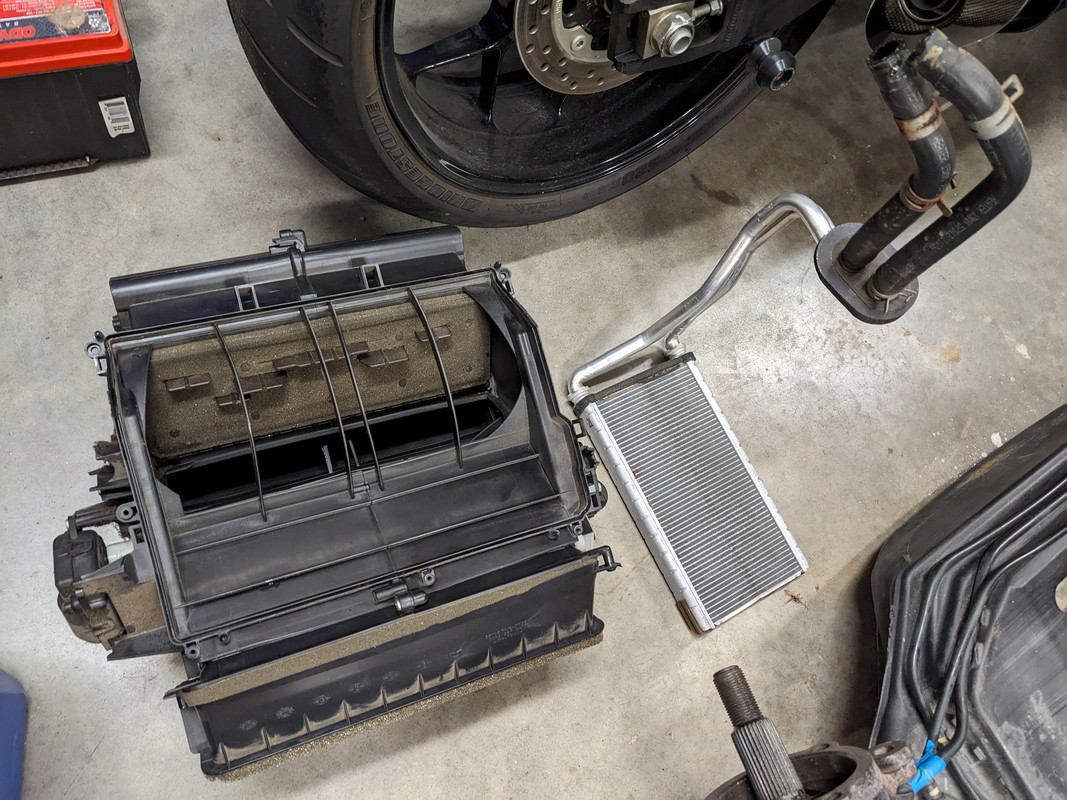

The heater core is out! It wasn't too bad. The left/center dash trim has to come out, and the HVAC panel and the lower net pocket panel. Then there are just four T-40 screws that hold the whole box in. The heater core slides out just like in the videos. There's hardly anything left of my dash and I'm thinking about just pulling the vents to clean them out as well. I took some photos but imgur is having issues so I'll post them next time. I'm going to redo all this ancient foam too. I gotta say, it feels like progress and I'm excited about it!

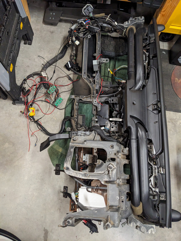

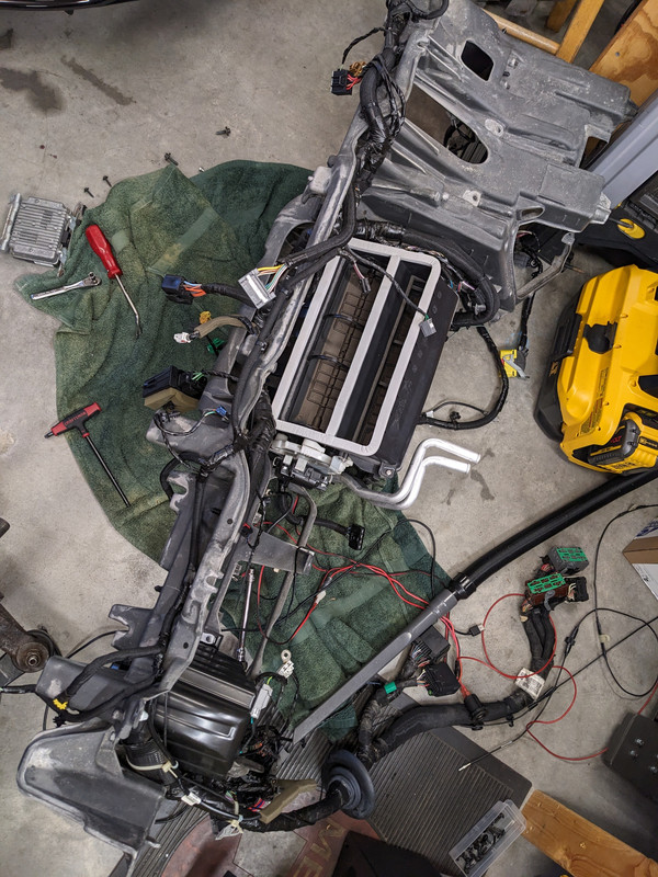

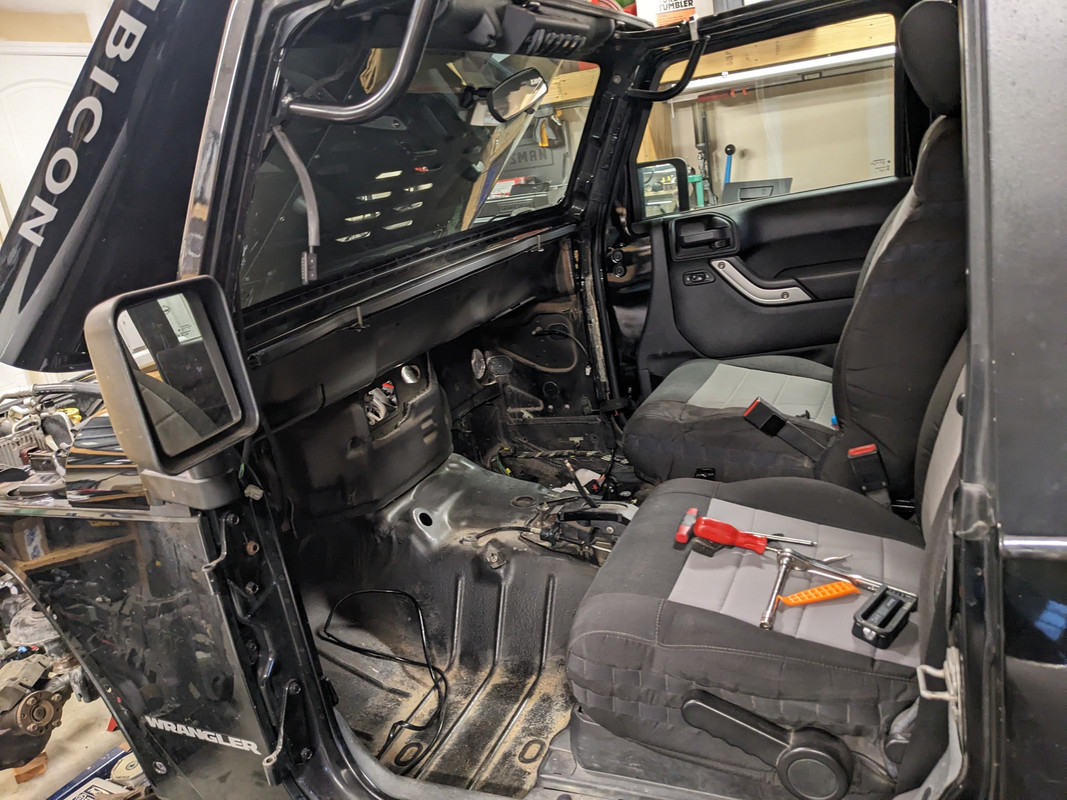

Ok! So progress today means more is out of the Jeep. It's a pain to work with the dash while it's sitting in the seats. I disconnected what was left (three whole connectors) and got a hand to pull it out.
Trying new photo hosting today, lets see how that goes. Shout it out if you have any issues with the pics.

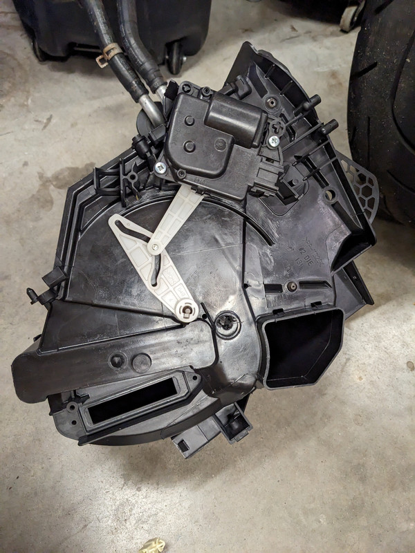

I took the 'Distribution Housing' apart and got to cleaning it. Even inside the vents and ducts it's really dirty. With all this accessible I might as well get the ten years of dust and funk out of there. One of the blend doors in the housing seems melted. I know it's not melted, it's degrading rubber, but part of the seal has turned into a sticky tar-like mess. I cleaned it the best I could but the whole seal is getting tacky so I know it's only a matter of time until it's just a pool of goop. Blend doors for this particular housing are not available individually. The housing (P/N 68089116AA) is $400+ from Jeep or about $280 from online retailers. While searching, I found another housing that's spec'd for the 2012 JK, P/N 68089117AA and lists online for $110. I went to the parts counter today to find out what the deal was and we figured out that the housing parts are different for auto and manual climate control vehicles. Mine was a loaded Rubicon when I bought it and it had the auto climate control. I didn't care for it and swapped to manual controls years ago. So I figure I can order the cheaper housing, use it if it's suitable, or steal the blend doors out of it and save myself $170. The shipping estimate is ten days from now so I'm trying to be ready for the dash reinstall by then. I also ordered the foam seal kit, mostly for the seals around the heater and evap lines. It comes with a bunch of other foam too. If it looks good I'll use it, if not maybe there's a better quality foam out there I can use.
I also swapped in more HVAC parts that arrived today. The blend door actuators come with big STOP stickers and the fine print reads that they need to be calibrated by a scan tool before use. I found a thread here with good info on that and I downloaded the JScan app. I already have a suitable OBD2 adapter so I should be good on that front.
The Jeep looks so empty now, and feels very spacious with nothing left inside but seats.
So now starts the race to clean out the bones of the dash and the vents. It will be much easier to do with easy access. I'm taking lots of pictures as I go, so if anyone needs a reference while all this is apart, put that request in and I'll get on it.

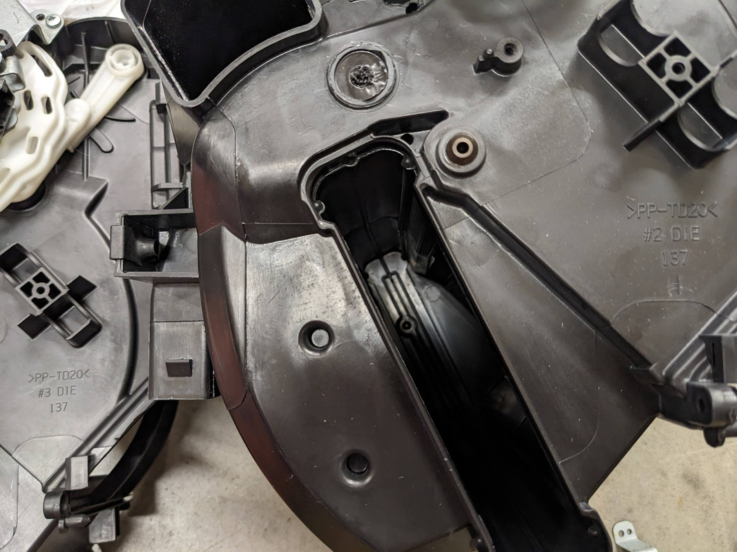

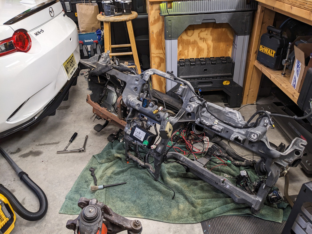

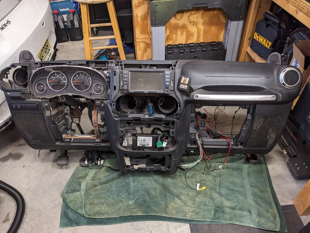

Thanks! Having been left to my own devices all day, things have progressed.. in a direction? I'm not sure which, but I'm having a good time.
I was pretty sure the full dash trim had to come off to get the upper vents out, though the real hold up was the radio mounting bracket preventing the center vents from pulling out. I guess it doesn't really matter, at this point what's another bunch of screws?
So long to the passenger airbag, gauges, radio, and then the small matter of disconnecting the tweeters. The large dash trim is a matter of about 15 of those 7mm screws, actually very easy and straightforward to remove. I've cleaned off most of the aluminum structure but there's plenty to go. I have the passenger airbag recall to do, I'm thinking about bringing that piece of dash trim to the dealer to see if they will "install" it in that. I'm also thinking about replacing the dash speakers so I'll have to do some homework there. I don't want anything crazy, just maybe a quality replacement speaker. I'm also thinking about cleaning up the steel braces and painting them. I'm sure the surface rust is a nice protective layer, but I have nine more days to kill. I'm also going to re-run the wiring I added for power and the CB and a handful of other things I don't yet recognize so that it's a little neater. Oh and who at Jeep thought it would be a great idea to save $0.002 per vehicle to shorten the window switch wiring harness so you have to ram your fingers into the dash and make a blood sacrifice to the car gods to get the connector off?? Honestly!

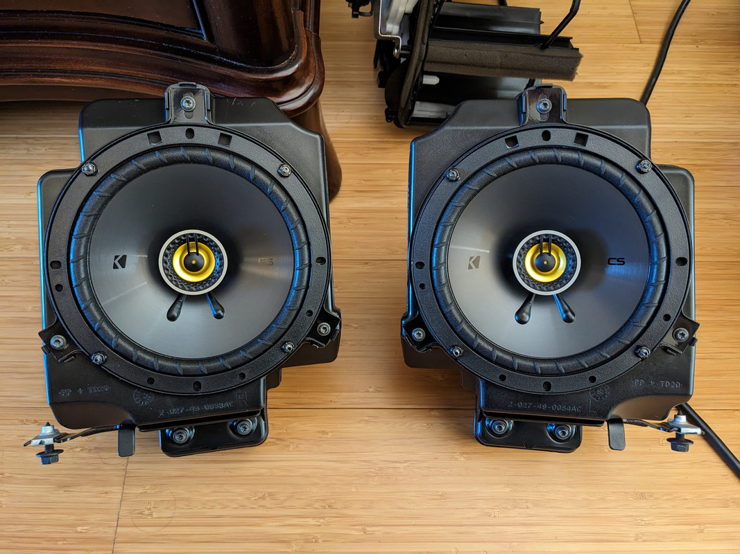

I ordered the 6.75" Kicker plug & play set for the dash and sound bar speakers. I'm not looking for anything more than OEM+ and minimal effort. That's certainly what this is so far, though the verdict will be out on sound quality for a while still. The brackets weren't a perfect fit, I either had to slice two locating tabs off the speaker pods or grind down two tabs on each speaker. Speakers come and go so they got a turn on the bench grinder. I stuffed the pods with polyfill and everything went together nicely. They sure look cool!

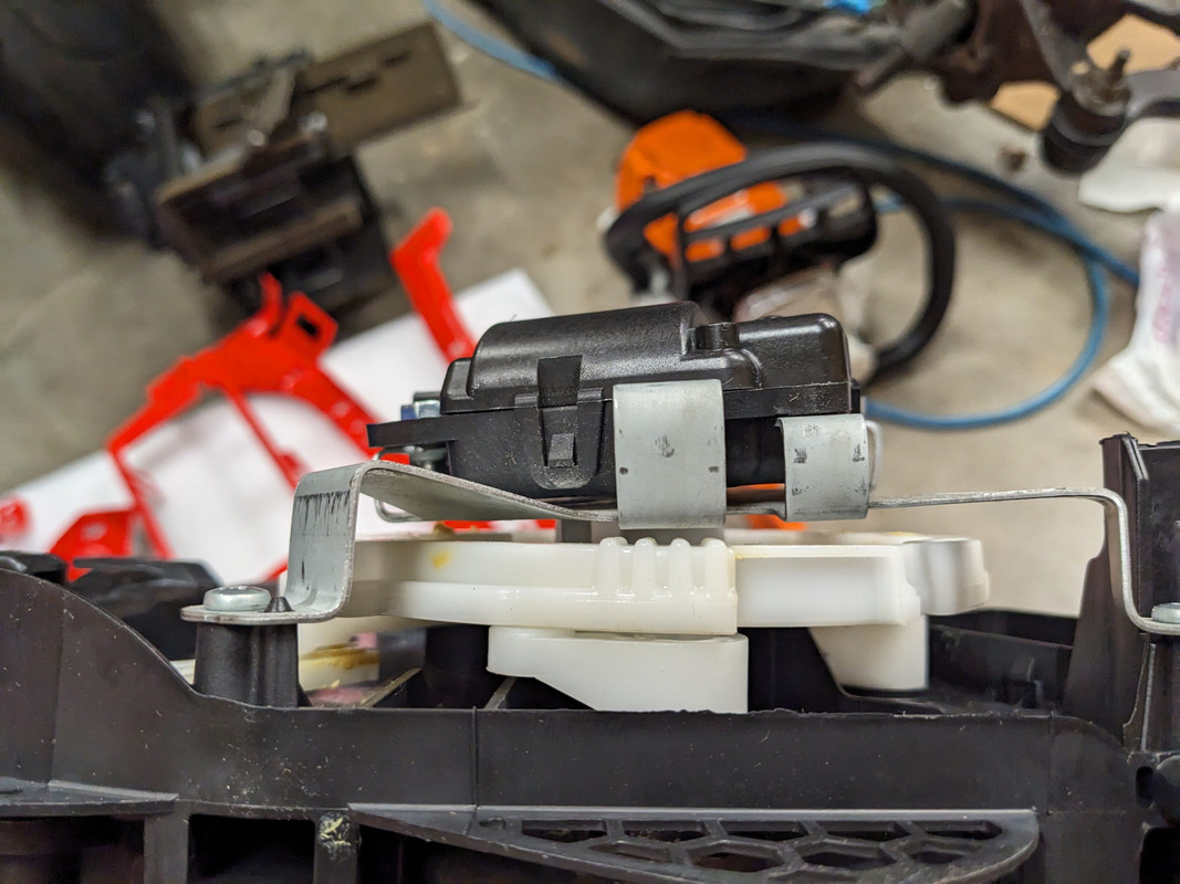

The distribution housing came in. This is the manual HVAC control part number, costs less than half of the auto control version, and I can't find a difference physically between the two. They are marked with different die numbers, but it stands to reason that Jeep might have more than one.
The new unit came with one actuator bracket bent and the actuator at a bad angle:
I'll bet it's been tossed around for a while since the JL came out. It came lubricated with way too much yellow mustard too. It also came with two actuators, of course after I already bought replacements. I'm going to use my housing, I like it better and I spent plenty of time cleaning it out. I'll snag the blend doors and actuators from the new one and then I don't know what I'll do with the leftovers. I ordered a seal kit with it which is a good thing because the new one didn't come with any foam gasketing, thought I guess that's moot since I'm not using the housing. I picked up various sticky foam weather stripping today too so I can replace everything around the vents and ducts that's not included in the seal kit.

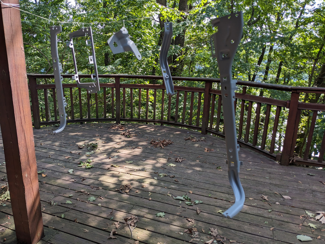

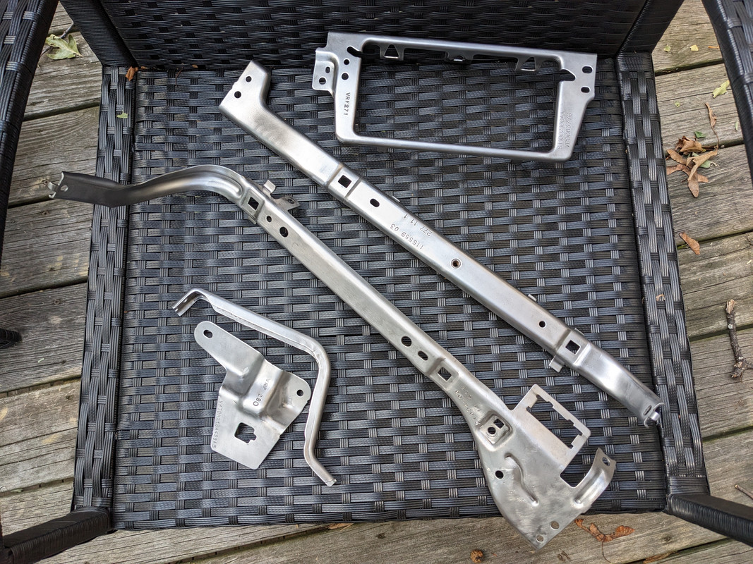

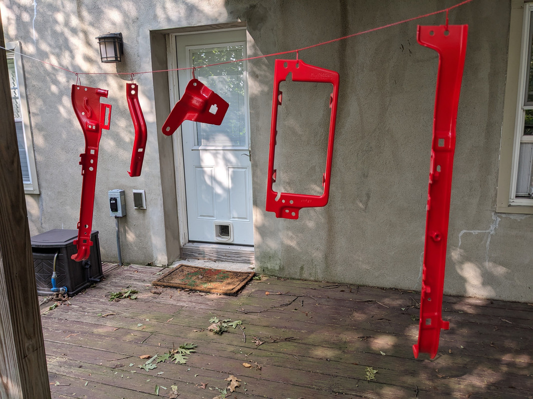

I caved and cleaned and painted the steel parts. It was fun.
Isn't everything better in red? No one will ever see them but I like it.

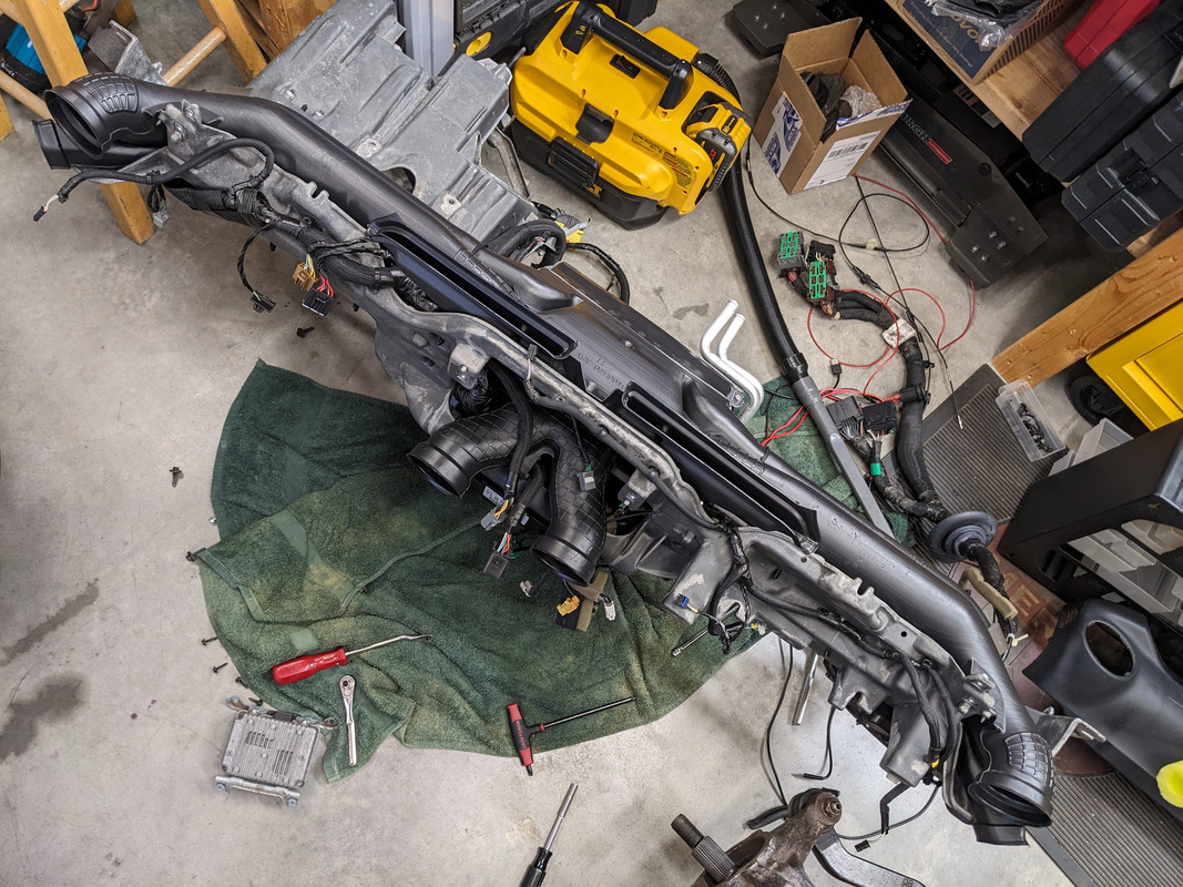

I finished cleaning the aluminum dash structure and all the wiring harnesses and connectors. I did find one wire which had caught on something and torn the insulation so I wrapped that up to avoid problems down the road. Everything else in there looks good.

I found the difference in the heater boxes. I must have been blind.
This cutout is in the MANUAL version. Mine, the AUTO climate control version is sealed. I don't know what's supposed to cover or plug in here, I don't have it. I'll take a look at the parts diagram.
I got the whole assembly put together with new foam sealant and installed.
Finished cleaning out the ducts. I used a rag and a long, flexible brush like a patch and a cleaning rod. Got them installed too.
