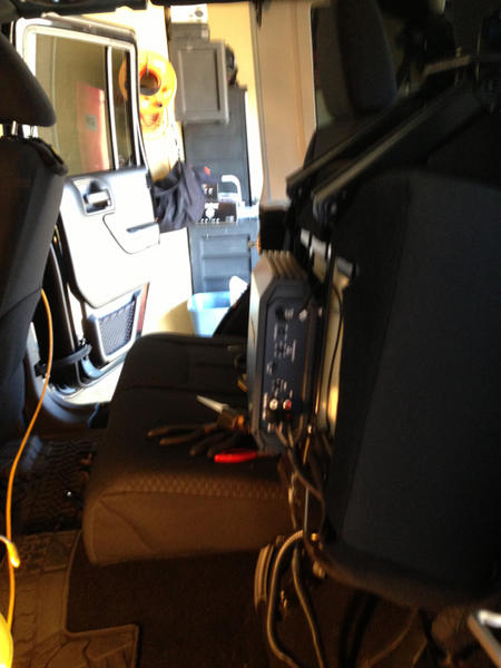

A friend fiberglassed his tub and put two 8's, now we're doing mine with a shallow mount 12" Fosgate. Space ends up being right at 1 cu ft or .5 on each side if you split it, so make sure to get a speaker or speakers with those specs. Mounted amp under rear seat hidden away. Fiberglass mats and resin were about $30 at Walmart.
