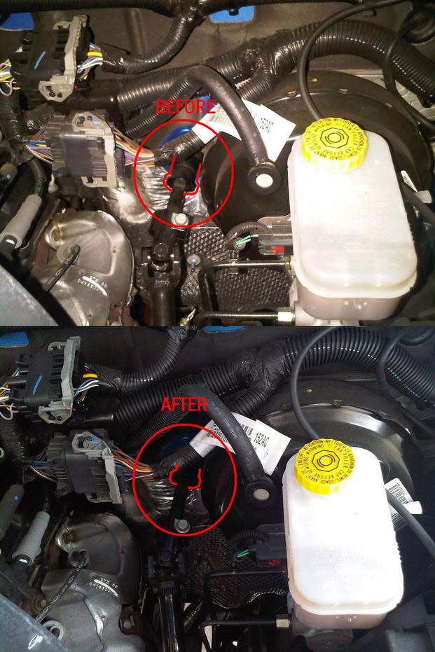

If you can only hear it inside when accelerating, check the plastc grommet on the steering column in the engine compartment. Mine slipped about 1/8 inch and sounded like an exhaust leak on acceleration. The dealer told me the same thing about it.
You were right! Yesterday morning I inspected that grommet before heading to work and I tapped it with a hammer but it didn't move. There was about half an inch of grease on the end of it so it looked like it had moved but I needed to go to work, so I didn't mess with it any further. This morning I went under the Jeep again and took off a splash plate to inspect the crossover pipe heat shield. It seemed like one of the tack welds was loose so I pried it away from the exhaust but the sound continued. I poked around at some of the other tack welds, and still found nothing loose. I went back to the steering grommet and noticed that the grease mark was larger so I decided that it had definitely moved. I tapped it harder than before with a hammer and it went back in. It seems like the grommet isn't very well secured and that this problem will occur again.
For everybody's info, the grommet in question is highlighted in this picture:
