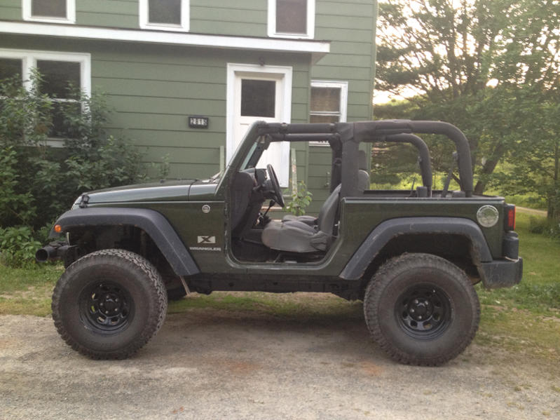

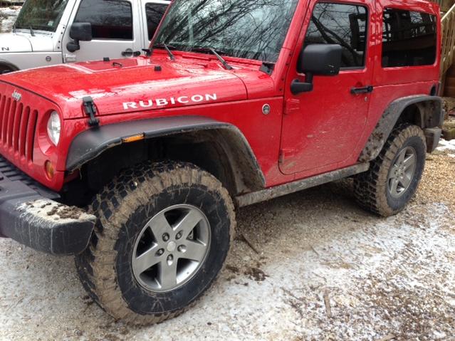

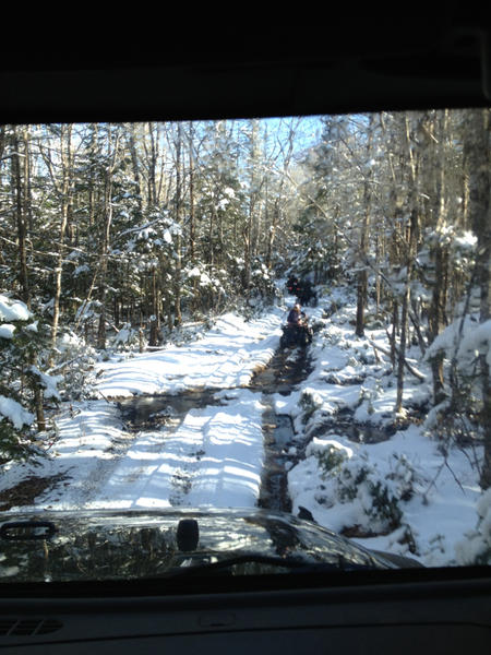

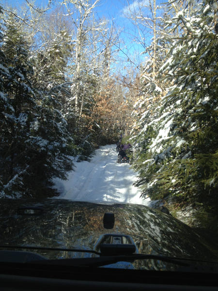

I've run BFG at for years now no regrets . Last a long time works good on road and does well off road . I run them all winter here in Nova Scotia Canada no problem .and I've been through deep mud holes with them no problems at all ! Just have to give her to keep mud out of the treads . I go through mud this wont
That's a 33(295/75r16) on 2 1/2 inch lift .

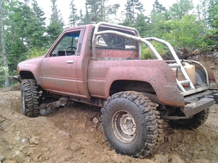

KM2 285/75R17 is a 33.8" with narrower tread width;
mileage & power does not suffer at all ( running 3.73 here )
it does sing a bit on the freeway ( turn up the radio )
you feel the aggressive tread during starts and stops ( who cares )
off road traction is excellent, wet road traction is good, snow traction is excellent
Where I live; if I had all terrains; I would need a winch on a regular basis.
